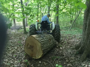

The guy I cut with is coming up on 75 this fall. He's slowing down a bit, but at the same time, he's out shopping for a new MS-441 Magnum. Hope I'm doing as well, when I hit his age.
Here he is, hauling what I'm cutting.

That's a pretty dangerous way of pulling logs with a tractor. It won't take much for that tractor to end up on top of him.
The guy has probably been doing it that way longer than I've been alive though.

It would be pretty tough to stand that tractor up, given the diameter of that log and the way we have it hitched to the drawbar. The front tires can only come up maybe 12" before the drawbar is on top of the log. Choking short is key.
The log is hooked to the 3 point hitch, not the drawbar.
There have been lots of people hurt or killed pulling like that.
I see what you mean though about the tractor not being able to stand up very far.

Around here, that bar placed between the lower links of the three point is also called a drawbar, just like the one mounted under the rear diff. Might be local terminology. I hear what you say about the danger, and only use that technique on a hydro tractor myself, never gear drive which can walk away quicker than you can reach the clutch. However, as noted, that log is literally choked up under the "drawbar", so they act as wheelie bars, in drag racing parlance.

Understood.
Just putting that out there for anyone else that might want to skid logs like that.
Thanks for the explanation. It might keep someone from getting hurt.

FWIW, I have known 3 guys who did this as a regular practice; it caught up to all three of them, none lived to see their grandkids. It was especially dangerous with the older ford "n" series (8n, 9n, etc) some of which didn't even have a fixed drawbar. From what I understand, with those particular tractors once they started over backwards the tension on the clutch was such that it wouldn't, or couldn't, be released.
Thanks for these posts. A few weeks ago I did a bunch skidding of big'uns with the three point myself and didn't even think of this. From now on it is draw bar all the way.
