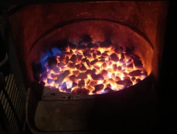

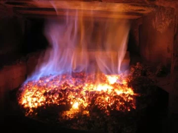

Bituminous coal can produce a lot of smoke, but anthracite burns extremely clean. I heat my house with anthracite, and every person that has seen my stove in action is shocked at the heat output and clean burn. It burns with no visible smoke and produces no creosote. See the attached picture to see what anthracite looks like when burned in an underfed stoker; the picture is courtesy of one of the forum members over at nepacrossroads. The second picture is nut-sized anthracite burning in my old hand-fed stove.
As for the EPA rating, when I bought my coal stove it came with a tag on the door handle that read, "Coal burning heater only". At this time, wood stoves are subject to EPA requirements, coal stoves are not. I'm sure that's the reason for the tag.

Jags said:
Battyice - I can feel the heat coming off of my monitor with that pic.
Rightfully so, the man who took the picture said the boiler is 250k btu. I added a second picture of my 1930's Heatrola burning nut coal, it is around 90k btu.
