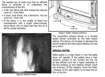

There are a lot, an awful lot, of variables when burning; everything from ambient air intake for the stove, wind pressure on the house, stack pressure or wind vacuum on the exhaust, pellet quality, pellet density, number of contaminants and noncombustible materials in the pellets; they all relate to how hot and how cleanly the fire burns. The damper is the way that Enviro chooses to deal with all of these variables at once, and it works pretty well. You just have to acquire a feel for how it works for your particular house with your particular fuel.
I'm suggesting that you should look at how the fire is burning versus trusting to manometer readings. It's right there in the book, notice the lack of reference to a manometer:

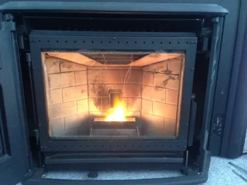

This is a great tip! The airwash holes are not mentioned anywhere in either the owners manual or the technical manual. I don't know why. After a closer inspection, i realized that they were somewhat dirty on my stove. I put my ash vac up to the holes and sucked out as much as possible. I never realized when cleaning the glass that if you smear the build up on the glass along the top and bottom edges there is a small gap between the glass and metal door frame that allows air in that can clog, thus making the airwash not work. It looks like the previous owner of the stove, and probably myself, would smear that around and it was packed in between the glass and the piece of metal at the top. This would explain why the top of my glass would get so dirty so quick. I happen to keep a set of dental picks in my toolbox and used one to get clear out that gap in between the glass and door frame. I'm hoping that will make a big difference in how clean my glass stays.
Just for anybody who is unfarmiliar with the holes in the door that we are talking about, check out the picture I'm posting. There are 18 square holes in the top and another 18 square holes in the bottom of the door frame. If you look about an inch below the top line of square holes you will see some white build up in the photo. That is where a bunch of crud had filled in that I had to scrape out to open up the airwash again. I hope this helps somebody else keep their glass clean a little longer.
