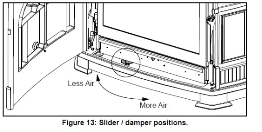

I've had an Empress FPI for a number of years and perhaps I can shed some light.
First, your door-glass sooting and ashpan filling are a result of your pellet quality. Honestly, I'd rather have the ashpan catch the remainder from the fire than have to clean it out of the innards of the stove. Quality from batch to batch of pellets varies wildly. I use one brand, from one source, exclusively and with most batches, the stove burns nice and clean, and with others it's like I'm burning old tires.
Second, you have to adjust your draft to take best advantage of your pellet quality. This is your problem right now. Your draft is set WAY too low. This is what's causing your glass to soot up so badly.
Open your front casting door and look below the firebox door glass on the left. There is a lever to adjust your draft. Move it about an inch at a time, see how it burns for a day, then move it again if necessary. (Although this first time I'd move it an inch and a half to two inches.) Adjusting the damper will have a real effect on the long-term buildup of soot on the glass. It won't affect how much ash you're getting in the catch tray, that's just noncombustible material from your pellets.
From my Empress Technical Manual:
[Hearth.com] Why is my Enviro Empress Insert producing so much ash?
Pellet quality is a major factor in how the pellet stove will operate. If the pellets have a high moisture content or ash content the fire will be less efficient and has a higher possibility of the fire building up and creating clinkers (hard ash build-up). If this happens, move the Slider / Damper to the right slightly to increase the air flow to the fire.
Some fuels may require higher or lower settings.
• If, after long periods of burning, the fire builds up and overflows the burn pot or there is a build up of clinkers, this would be a sign that the pellet quality is poor, this requires more primary air, the slider
damper must be moved to the right to give the fire more air. The easiest way to make sure that an efficient flame is achieved is to understand the characteristics of the fire.
• A tall, lazy flame with dark orange tips requires more air – Push Right
• A short, brisk flame, like a blowtorch, has too much air – Push Left
• If the flame is in the middle of these two characteristics with a bright yellow/orange, active flame with no black tips then the air is set for proper operation.
Now, about outside air kits. The Empress FPI has no fitting for an OAK. You can install one if you really think you need it, but my house is fairly tight and I have never needed an OAK.
Honestly? I'd try adjusting the damper before I ever considered installing an OAK. Just MHO.
