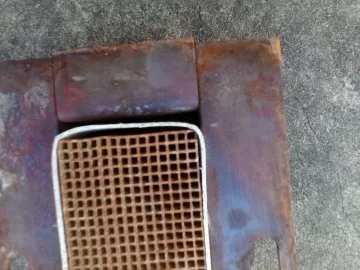

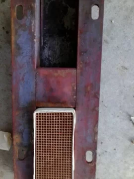

And here are pics of the housing and how they sit in there.

The last pics are of the chimney side. They sit in a "C " channel if your looking at a cross section.
Oh..so the ends of the "trough" are open?
Look at the pix where I posted no cats in the housing. See where the smoke enters through the side. The cats sit like an inch off the bottom plate. The smoke goes through he cat. Through the stove and up chimney.
Ok..just didn't look right to me..could not understand where the air was interring.

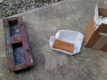

I think I'd burn it a few more times and see what happens. Maybe the gasket didn't fully expand yet to seal the gaps? I don't think it's suppose to be super tight in there and your suppose to leave a little slack for gasket expansion.
Its not super tight but snug. I filled gaps as directed to by applied ceramics, the maker of Firecat. I sent him pics of the fitment as it was way too loose with one wrap. See pic.
