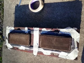

That cat housing should definitely have a gasket between it and the stove body.
I just had the stove out before the fire. And it goes back all the way. It just is like a half inch plate that slides sack over opening . It closes onto a lip.
Talked to stove manufacturer and they said there is no gasket there or needed. Smoke will take the easiest way out. I may pull it back down and use the old window glass gasket I pulled off and tape it in place on the housing g and rebolt it back up.

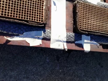

Pulled the cat housing down. I took the old window gasket out of the trash that I pulled out earlier this season. I cut it up into lengths and then taped it to the top of the housing where it mates to the top part of the stove.
Stove never had a gasket here nor was designed for one but this should seal any gap that would be there.
The tape is just masking tape to hold it in place. This was 1 year old window glass gasket. Gasket was still good but there was no sticky. I pulled it out to change the window gasket as it was not tight. I doubled up the gaskets there to tighten it up. Previous thread somewhere here about that.
It did look like smoke was sneaking around the ends on the small side. Since I was burning mostly pine the soot track was noticeable. Not crazy but noticeable.

That gasket should do it but I would rather see you use flat gasket material made for putting the cat in the can so to speak.
Speaking of it still looks like a decent sized gap between the cats and the holder?
That is flat window gasket. Other is flat "cat" wrap gasket around the cat. The gap you see is burned up gasket.
Look back to the original pics. Its there its just soothed up. I am positive no smoke is making by, right around the immediate sides of the cats in the housing.
The latest pics look a little deceiving as the gasket looks loose around the long edges of the cat. That's because its just flipping over. They sit raised up a 1/4" from the housing. But that gasket is right where it sits against the metal.
