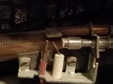

On the back side of the horizontal pilot burner (where the pilot flame actually comes out) there is a small hole, maybe 1/16" to 3/32" in diameter.
This is the ODS (Oxygen Depletion Sensor). Check to see if it is plugged with dust or lint.
You can try blowing it out with compressed air. It is a common symptom for that type of unit.

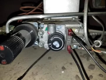

If that doesn't work, you will probably have to replace the ENTIRE pilot assembly (your first pic)

What's happening is if I hold the pilot, I can hear and smell the gas coming out. While holding I hit the spark. I see the spark, still hear the gas, but no pilot light comes on. If I don't use the spark, but use the lighter, everything works. With that context, could it still be the O sensor?
Does the pilot stay lit when you use the lighter & release the pilot knob?
Is the spark actually IN the gas flow from the pilot burner?
The pilot stays lit when I use the lighter, it is a blue color. Once the pilot is lit, everything works as expected. It stays lit and I can turn the fireplace on and off. Through visual inspection, the spark is in the way of the gas. When I use the lighter, it sits inside the pilot flame.
Where does the spark jump to? It should jump to the pilot burner, nowhere else.
Is it possible he needs to clean up the ignitor and contact surfaces? Maybe some corrosion is causing a weak spark.
