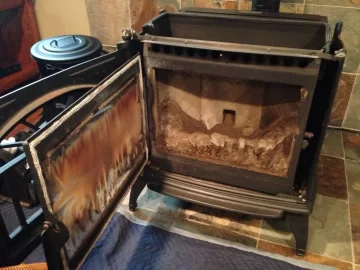

Customer is adamant that she needs a new igniter. She was having trouble igniting towards the end of the season. "Make sure you order the igniter and bring it with you",she says. I tried to explain that empress igniters don't usually ever fail...but I caved and got one and got a new burn pot.
Found the problem...

;lol She needs to clean the glass! Wow, she was really trying burn the stove like that?

For those of you that have Enviro stoves with the burn pot and burn liner design (all stove except for m55 designs), if you are having problems with ignition and the igniter is glowing orange. Pull your burn pot liner out and look for cracks between the holes on the back and bottom. If these cracks are present, chances are the liner has warped slightly and is not sitting flush in the burn pot. The hot air from the igniter will escape up the back side if the liner is in any way crooked.
You did sell her the igniter and firepot, did you not?
The customer is always right. >>
she clearly needed a new firepot and igniter...they're both gone in that pic.

i bet she never cleaned those 2 combustion ports on either sidde of the stove how was it still running i those vacuum switches on the enviros arent to sensitive huh

My prices are as advertised on my site. It took all but of .015 seconds longer to clean her stove than any other stove I go to. They all get treated the same. Oh, and instead of selling her parts she didn't need I spent a little extra time consulting her how and what to look for...She was actually emarrassed. Truthfully, I would rather they not clean it and let me see it this way...least then I'm not scratchin my head wondering what the problem is.
