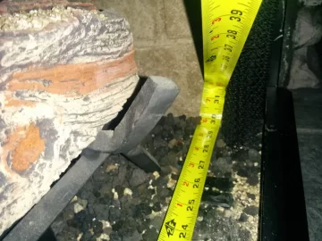

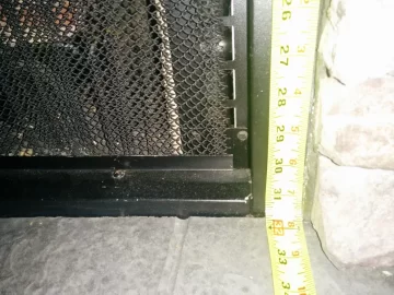

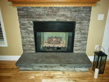

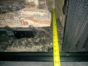

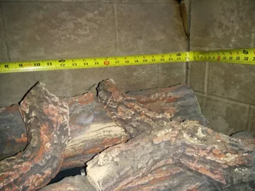

Here are some photos to provide details of what I've currently got.
[Hearth.com] Wife wants to add another wood stove w/ a pretty flame show [Hearth.com] Wife wants to add another wood stove w/ a pretty flame show
Insert height = 31.5"
Insert front width = 30"
Insert back width = 25"
Insert depth = 21"
All these measurements are internal firebox measurements. Overall outside dimensions of the insert are, no doubt larger.

I don't see any chimney. It looks like a gas only fireplace. If so gas is all it's going to burn. Is it an unvented unit?
I don't see any chimney. It looks like a gas only fireplace. Is it an unvented unit?
It's ventless. We would have to add a chimney.
That's a no-go. You'll need to do more than that. You would have to replace the whole thing with a ZC fireplace with a full chase or come up with a new plan like moving the F55 into the living room and adding a chimney.
Reactions: stoveguy2esw
Expect a full rebuild. There is basically "nothin" you can use from the old ventless.
There we go. I sort of suspected as much. I'll continue to watch the thread. Thanks be green and jags!

Other option would be to pull out the insert, finish it as an alcove and put a stove in there.
In the mean time, you can tell your wife that she is not wasting that much money. A ventless fireplace is close to 100% efficient, the only heat lost will be through the walls surrounding the insert. Thus, the difference is the cost of propane versus the cost of your wood.
I'm not sure that would work either without extending the chase. It doesn't look like there is enough height to the bump out for a proper wood stove alcove.
