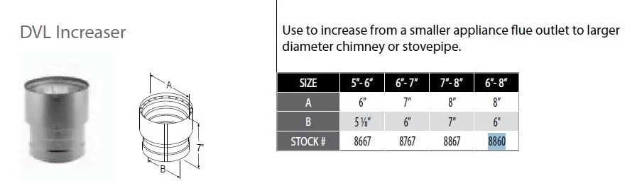

I emailed Englander stove company and it said the 8" pipe should work fine if the chimney is well designed. So I am banking on not having to mess with it. Can I find the adaptors (6" to 8") at hardware stores like Lowes or Tractor Supply?
They are easier to find for single wall pipe. Probably not for double wall pipe. Is your pipe DVL? If so the part number is 8860 for 6" to 8".

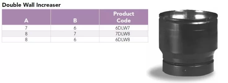

From what I gather my pipe is double wall. Security Chimney is the brand. HT something or other. Canadian made. I have a decorative outer liner from top of existing stove to about 6" before ceiling, then a black cap that rests on ceiling, and then the rest of pipe from there up. Think they have what I need at Lowes or local?
Wouldn't have to be. I was gonna do a rigid liner too, but I went the flex liner route 'cause the rigid liner was quite a bit more money...
Ah, that's right. I kind of doubt you are going to find this at the local big box store. Call around first or order online. That "outer liner" is not decorative. That is the Security DL connector pipe design. You want this part 6DLW8.
