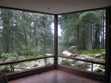

Oh, for fun . . . I've attached some pictures so everyone can see what 'the little VC that could' is up against :-)
Thanks again for all the super advice and for taking the time to share it.
  • [Hearth.com] Will a stove upgrade save us money?
No advice for your specific situation, but wow, what a view!!
I live in Oregon and if it was me I would leave those windows as they are and quickly buy a more modern stove. My neighbor has a larger Quadrafire & he sometimes has to open a window it gets so hot inside. I'm not so sure what you mean by paying to have your old stove removed & destroyed. I see a lot of older stoves for sale on Craigs list.
Some thoughts after viewing your photos:
The payback on a new wood burning stove will be heart-breaking slow. Get one to reduce the trips to the woodpile, to making flue cleaning less frequent, to (possibly) make attention less frequent, or because you just want one, but not to save money.
$30 - 50 thousand would buy rather a lot of insulating shutters, which would dwarf any savings new windows could provide. http://www.outerware4windows.com - or any number of other providers.

After much thought, and after receiving great advice from everyone, we've decided to do the following:
1) Get a new stove - we'll have to pay to remove and destroy our old VC Vigilant anyway if we sell the home (Oregon law), and we'll feel better about using a more efficient and more enviro-friendly stove.
2) Thermal blackout curtains on the windows. It will be better than nothing, and it's an affordable option.
3) Install a ceiling fan to push the warm air back down from the peak of our vaulted ceiling.
Since replacing the windows is cost prohibitive at this point, and since whatever could be insulated has been insulated, I think this is our best move.
