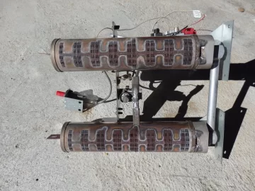

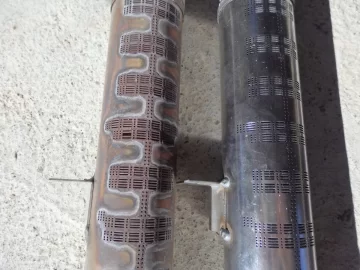

Bringing this thread to a close, I replaced the burners yesterday morning and the extinction pop is completely gone. I've attached a couple of pictures of the new and old burners for reference.
Thanks a bunch again Lennox65, I would not have known the burners could be the problem without the information you provided.
