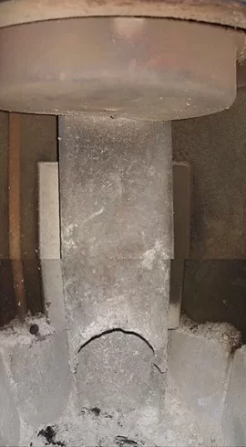

Here are some teaser pics of my stove unrestored, as it might look restored, and the internal modifications I made.

Well ya know that's going to generate some curiosity ;-). Is that a cat honeycomb in there?
BeGreen wrote:
>Well ya know that’s going to generate some curiosity. Is that a cat honeycomb in there?
Yes sir, it is.
At the moment, I'm running a 1" thick (cheapo) model with a few years on it, but I checked this afternoon and got a reading of 900* immediately above the cat with 500* at 12" above the stove top... both measured with Condar probes.
I have a new 'name brand' 2" thick in reserve which should give even better result... but I might wait til next season to install it.
I may not be EPA compliant, but I think I'm doing better with the cat than without.

By the way...
Most of the modifications were made with 'found objects'... and a hacksaw and bench grinder.
An internal 'flue' made of rectangular box steel (now burned to a rough archway as seen in the pic above) opens near the firebox floor and leads up (through a right angle) to a baffle (a stainless frying pan with a cutaway to accomodate the flue) - where the exhaust is ducted up to an added catalyst.
The supporting platform for everything is the bottom of a 35 gallon oil barrel, which made a nice fit in the top of the stove. The catalyst top guard is made from a 'cast off' cast iron Dutch oven. The catalyst slide cradle was made from an old brake rotor.
Firebrick surrounds the lower firebox to help retain heat. A supplementary air supply feeds a nominal amount of preheated air to the fire when all drafts are closed.
The basic mods have served me for almost twenty years now... with some repairs (and catalyst replacements).
All in all, it was more fun than just shelling out for a new stove, but I think I might trade up one of these days to something with a glass window.
Peter B.
