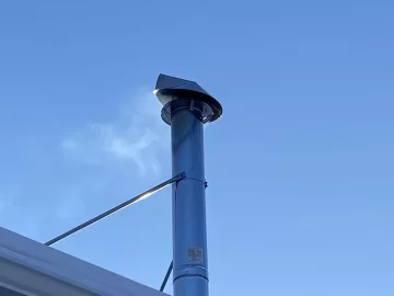

Well that worked out well!
RomanW
My stove has been super finicky the last couple of months, and yes, I'm still getting used to how to run it. But we get some pretty serious wind here (more than I'm used to), and it was causing havoc with the stove. Even had it push smoke out of the joints once on a big gust (While fully warmed up).
Anyways, even when it was nice out with no wind, it never really ran on low very well, and my secondaries only lit up around halfway open. (Escape 1800, with 14' chimney)
Well, I bit the bullet and got the revolving rain/wind cap from ICC, and what. a. difference.
I now burn 5-6 hours on low with pine (3-4 before), and the secondaries are going almost all the time now. I can hear the wind howling out there and the fire just carries on like nothing is happening. Sure, it looks dumb... but hey, fixed is fixed (or maybe just improved lol)!

I've been toying with that too.
I have trouble with a strong wind straight out of the west. Even a slight bit off-west is fine, but straight west can be poor at times. Annoying, for sure.
I know burn 5-6 hours on low with pine (3-4 before), and the secondaries are going almost all the time now. I can hear the wind howling out there and the fire just carries on like nothing is happening. Sure, it looks dumb... but hey, fixed is fixed (or maybe just improved lol)!
I see someone else forgot to take the label off their stove pipe. Man I thought I checked three times on mine.
That would be chimney pipe. Stovepipe is the connector pipe inside the room. It's ok to leave the label on the chimney pipe and helpful for later ID.
