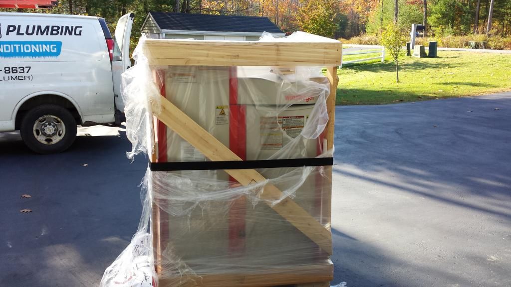

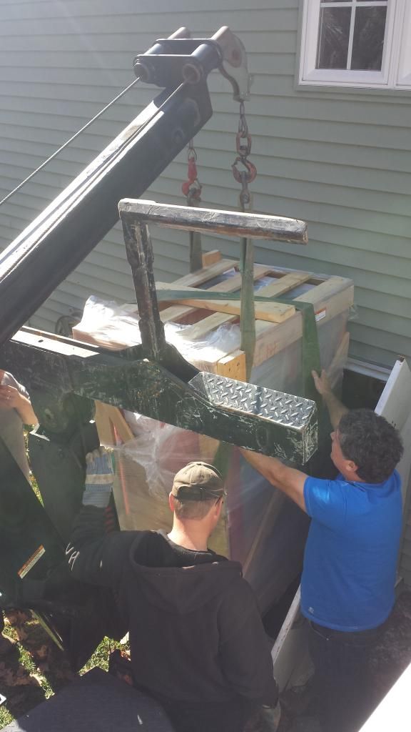

[Hearth.com] Windhager Biowin 260 install with photos
Lowering into the basement

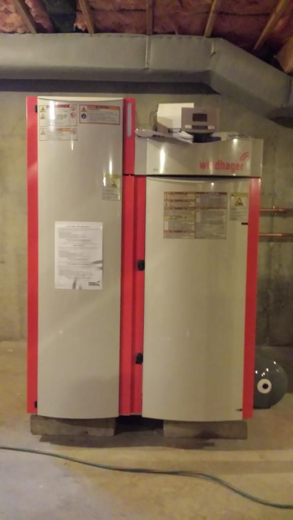

Uncrated and ready for electrical and plumbing

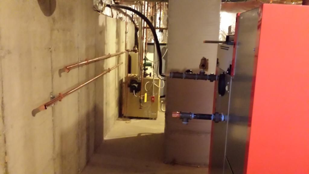

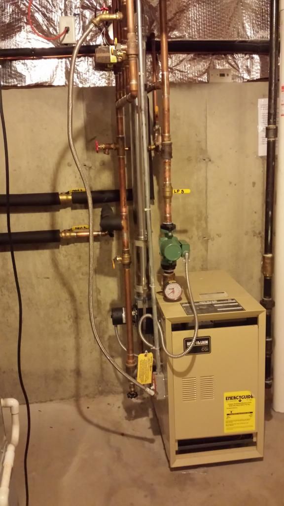

Tied into existing system

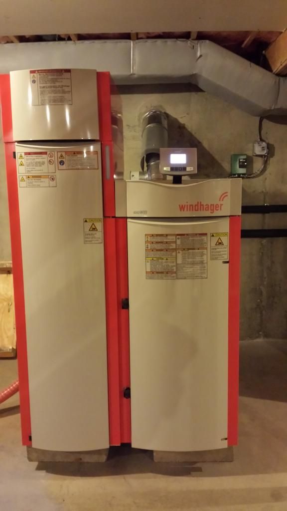

Up and running

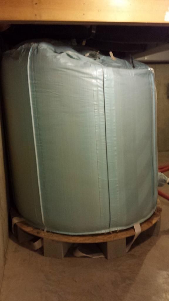

Bulk pellet delivery from Maine Energy. They're great to work with!!
3+ tons of pellets

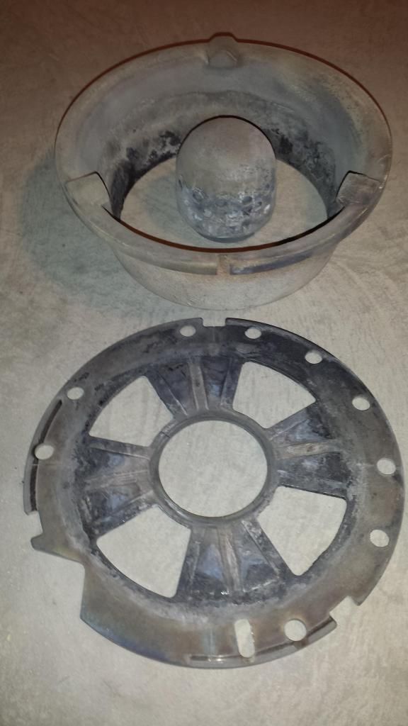

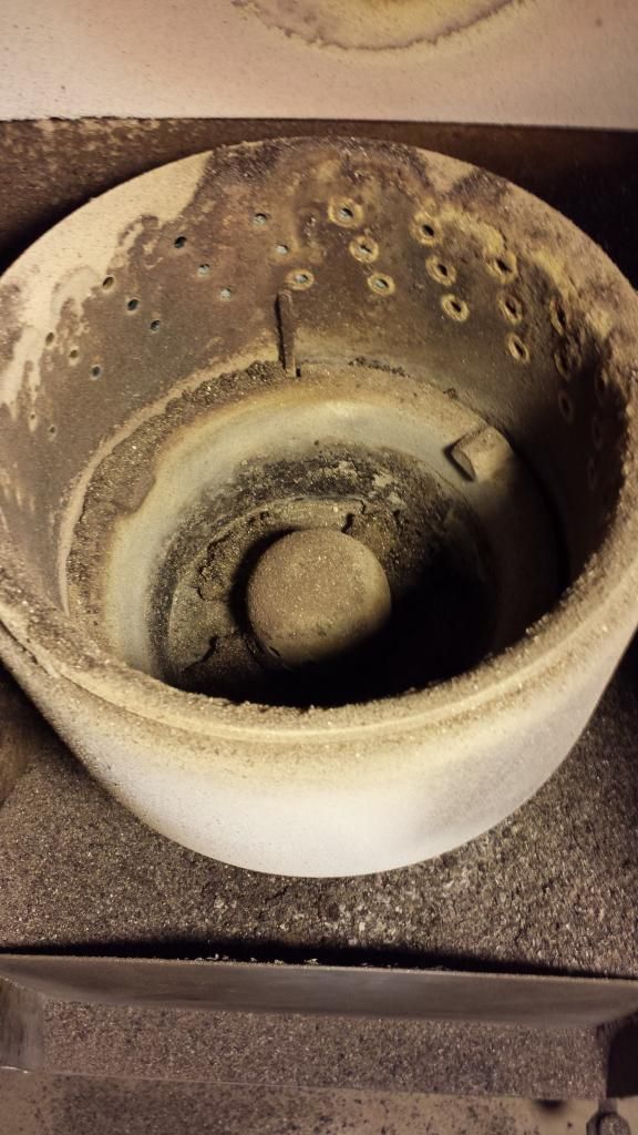

Burn pot

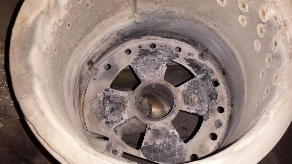

Inside the burn pot after the cone, air pin, and grate are removed for cleaning. The Biowin includes a handy tool to easily remove the cone and scrape off the residue.

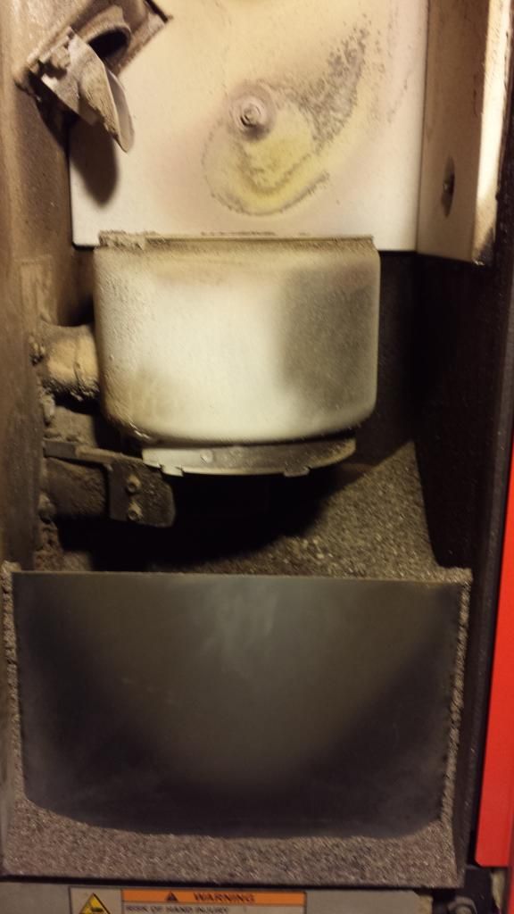

Clean burn chamber
Clean cone, air pin, and grate

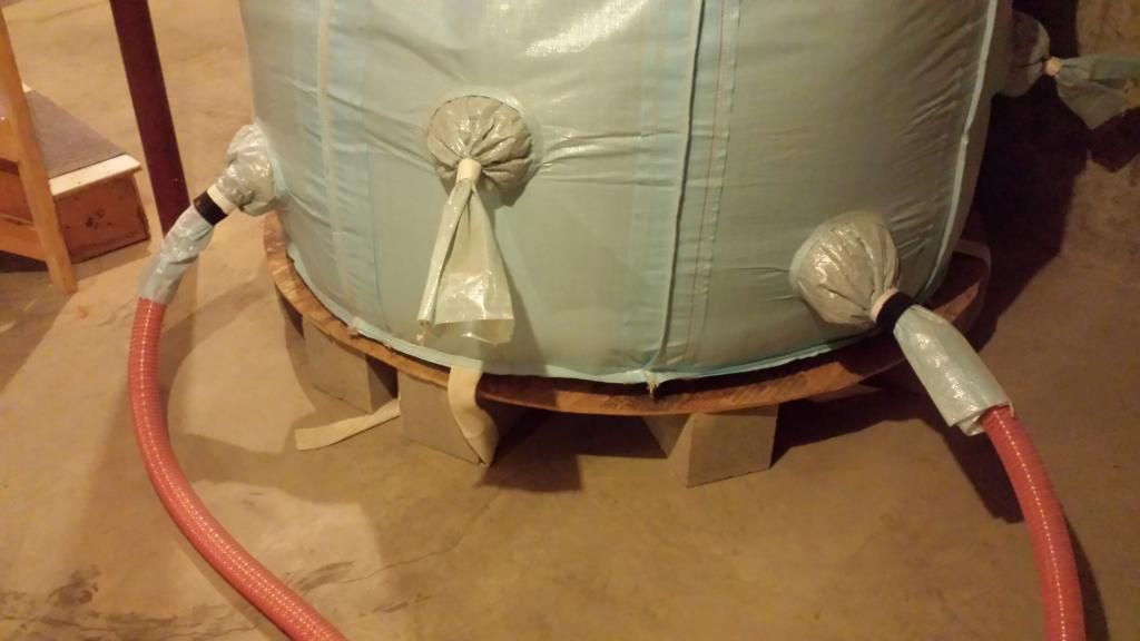

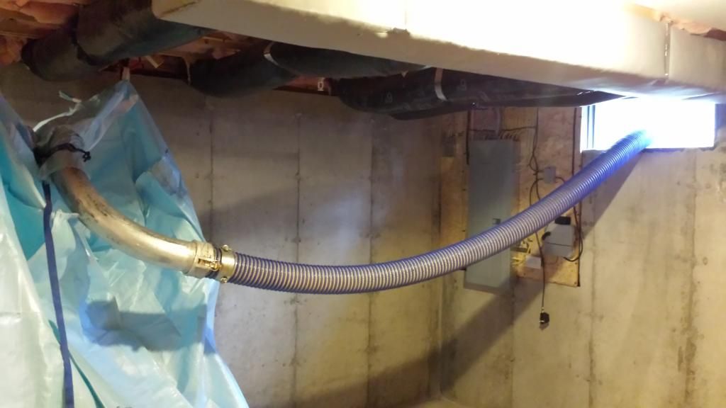

Very impressive Paste. I'd love to see a pic of how pellets get from the bag to the hopper. Since there is no storage does it shut the fire down after pellets in the cone are consumed? How does it avoid idling like my wood non-storage boiler. I think Heaterman explained this before but I forget. Also it looks like a small flue that isn't a high temp, double wall. Pretty attractive if for whatever reason I can't process wood in my future. Congrats, impressive.

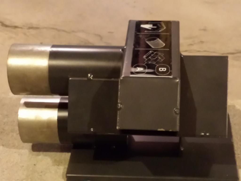

The pellets are transferred from the 3 ton bin to the boiler hopper via suction. The boiler hopper holds around 100+lbs with the turbine installed (or if you remove the turbine it holds 330 lbs if you want to just dump bags of pellets in like DanaB). The suction turbine turns on for 30 seconds about once a day as we consume about 80-90 lbs/day this winter. The boiler has an auger that feeds the burnpot from the boiler hopper and the boiler can modulate from 30-100%. Windhager specifies the flue to be UL-103 rated; flue temps range from 160-220 degrees. We're really happy with the system and we got lucky with the timing; we'll save over $2600 on fuel this year when compared to propane.
Suction probe inside the pellet bin. The lower tube is for return air and the upper tube transports the pellets.

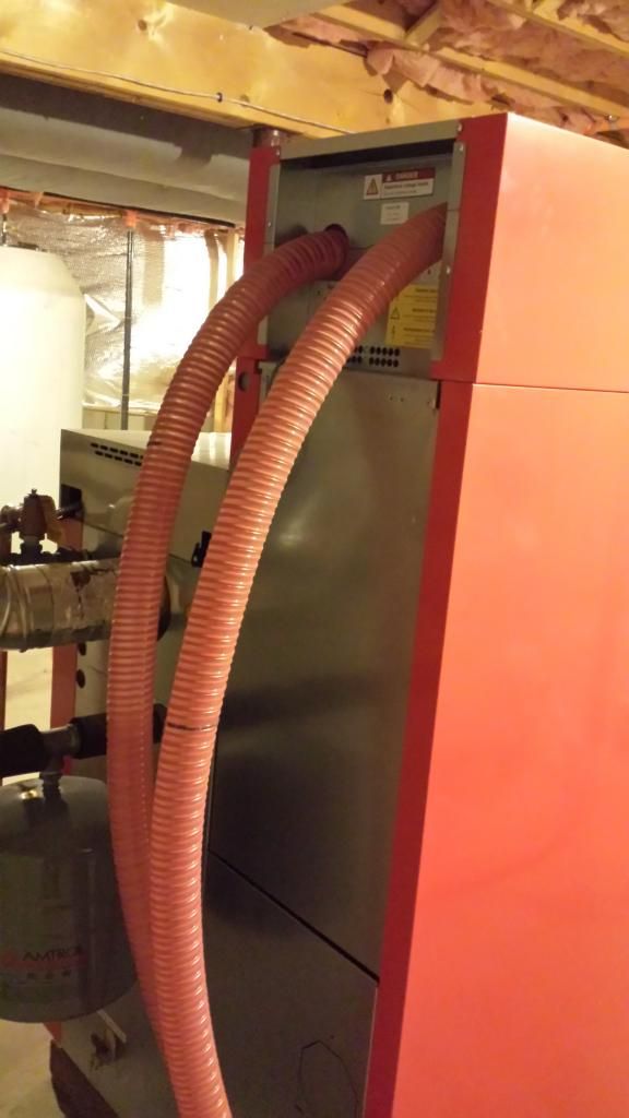

Left hose is return air, right hose is for pellet transfer.

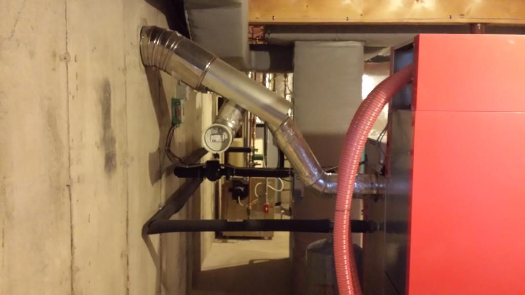

Suction tube entering boiler hopper

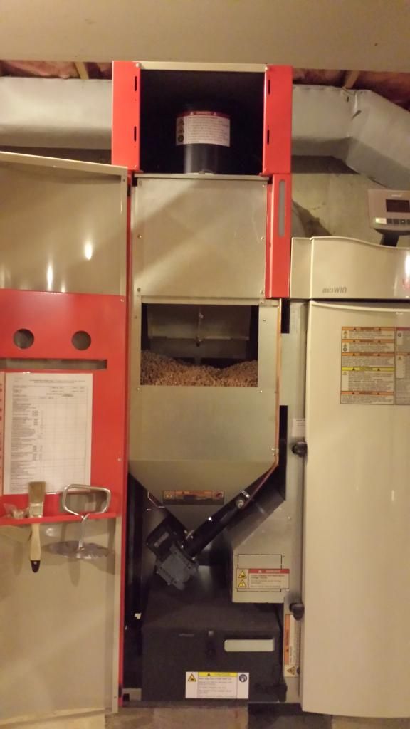

Suction turbine on top. I removed the panel on the boiler hopper, so you can see the pellets inside. The boiler auger and ash bin are below.

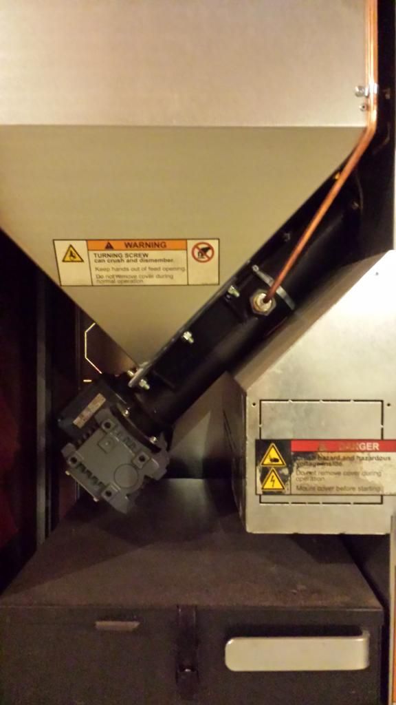

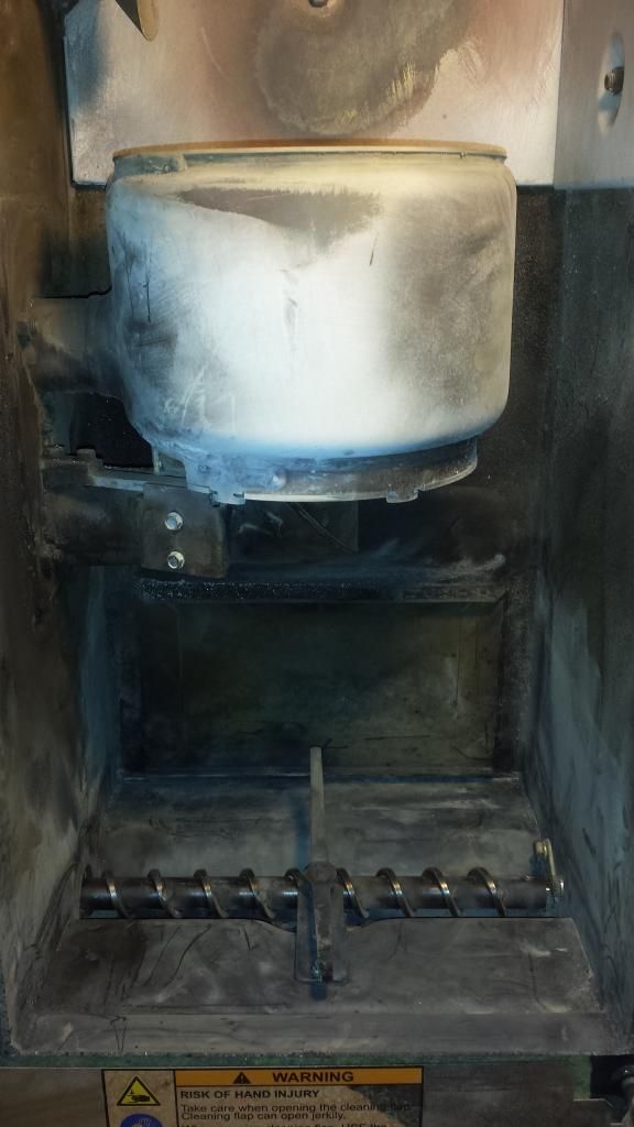

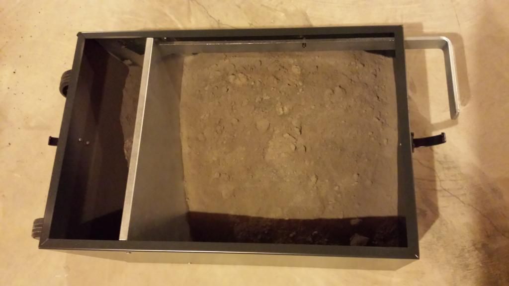

Boiler auger and ash bin. Copper tube is for the built-in fire suppression system.
