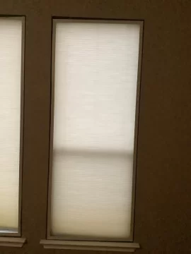

Our master bedroom is on the second story of our house and has a wall of windows that face west. There is some shading from trees, but the windows turn the place into an oven. We have cellular blinds that we leave closed pretty much all summer and in really cold days and nights in the winter. In this room the existing blinds are in between the glass window and the window insert, and that setup really helps cut down on heat transfer.

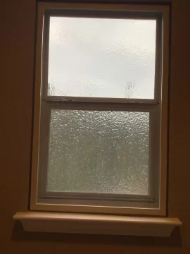

This second photo comes from the north side of our house. The night before last we had freezing rain move in from the north, and the windows were completely glazed in the morning. These windows do get some sun in the morning because it’s not straight north, but it has been cloudy here and well below freezing. Nevertheless, we think it is a testament to the window insert that the ice has not yet melted from our interior heat because of the window insert and air gap.

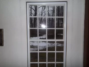

Thanks for the writeup. They can look OK in traditional wooden windows, but it helps that I happen to have white as a main color in this room. I only use them for the heating season.

Thanks for posting that picture. You’re right that the white works just fine there. Our windows are beige as are our inside walls and outside walls. It was nice that they had almost an exact match for our color.
