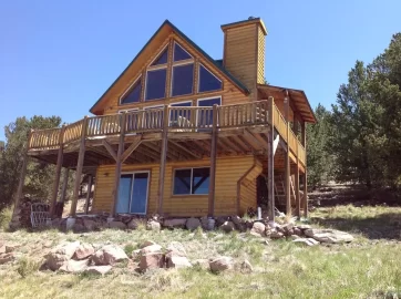

Without pictures I can only tell you the installation instructions for the 1949 recommend NO bends and recommend increasing to 4 inch off the stove all the way, including inside larger Class A all fuel chimney.
The 2014 recommends NO bends and to use 4 inch minimum connector pipe before the 4,5, or 6 inch Class A chimney. I'll assume your chimney flue is 6 inch. This is over 4 times the diameter of stove outlet which is going to give problems with any stove using natural aspiration to cause atmospheric air pressure to PUSH oxygen into combustion chamber intake. You're going from 7.06 square inch area to 28.26 !! Plus bends, plus possible 3 inch........ PLUS you are at high altitude with lower air pressure to push into the stove even if you had the correct differential pressure which you don't. Expect the stove to put out 1/4 to 1/2 the rated output. (you need 4 times the amount of heat in the flue to cause the same draft you would have with 4 inch straight up all the way).
Your posts allude to having 3 inch vent WITH bends. If that is the case, each bend adds 3 feet of pipe resistance, more if you are using 3 inch, plus you have an unknown amount of horizontal run.
ALL diagrams show straight up venting.
*** Since your installation requires bends, I would change the vent to 4 inch pipe (double wall or insulated instead of singe wall) then continue the same INSIDE the larger Class A chimney all the way.
You need hotter rising flue gas than a normal installation at sea level so pack the inside of Class A with insulation and block off plate to keep your inner flue temps high to increase draft. ***

Do you have grid electric or are you off grid and what made you decide on the Wiseway? I looked at your pic and didn't see any lines coming in but they could be buried or behind in the view.
no we are on the grid the power lines are buried to keep the view unobstructed and yep i am going to change out the flu pipe and see if the draw improves.
