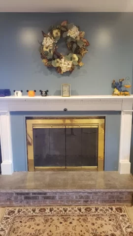

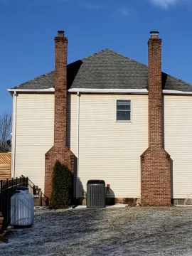

I am picking up a BK Princess insert on Thursday for a planned DIY install over the next 2-3 weeks. Attached are pre-install photos
![[Hearth.com] Wish list for new insert install [Hearth.com] Wish list for new insert install](https://www.hearth.com/talk/data/attachments/249/249411-58c97acef05bae750e56b6c122bb6ec5.jpg?hash=TmvlsU2qmP)
![[Hearth.com] Wish list for new insert install [Hearth.com] Wish list for new insert install](https://www.hearth.com/talk/data/attachments/249/249412-b6d8af90c6dba5cd61ba7ae5fa1973b7.jpg?hash=kVshHjvow-)
Before I embark, I have a couple of questions.
1. I thought about installing a key damper. This would be a 6" damper in a rigid section of pipe that is attached either to the appliance adapter or slightly above and have an extension rod that is then run to the front of the fireplace. I have seen a thread here where that was done, and I know I can fabricate the needed parts. My question is: is a damper needed on this BK given I will have about 25-27' of insulated 6" liner on an exterior chimney?
2. Ties into #1 above, but can stand alone. Is it advisable to install a manometer now while in the build phase. Obviously easier to make the connections and run the tubing with the insert not yet installed. Is it preferable to monitor draft (especially in a BK) or is it overkill?
3. Along the same lines, is it preferable to add a flue temperature probe (ie Auber) to the lower flue/upper flue to monitor? Clearly this is a lot easier to do when installing the liner before it is buttoned up.
