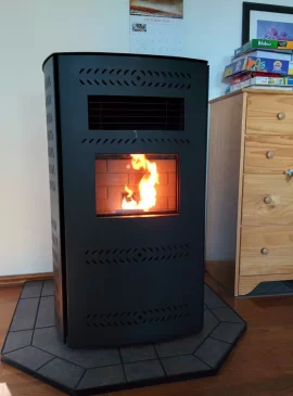

[Hearth.com] Wittus Club - Englander 25-IP - Harman Accentra Here is the stove installed, looks fine and seem to work.
It's not cold enough here yet to really see if it warms up the home. Install was easy through the wall with the venting kit, just the thing is heavy.
My only complaint is the noise, the exhaust fan is really noisy to the point of being annoying. It makes a loud 1kHz sound. Not sure how to fix that, I could wrap the whole fan in fiberglass but it may overheat the motor. Any idea?

Hi Lostdrum, congratulations with your new stove. Looks really nice. As for the noise issue, I can tell you that I experienced exactly the same whining sound from my convection blower at the 3/5 setting. The remedy was VERY simple, and I found it by studying in depth the original Whitfield owners manual. The engineers at Whitfield have been aware of this problem of triac-chopped signals that turn acoustic in the windings on the motor, so on the back of the control panel there is a trimpot to finetune the voltage fed to the blower motor away from the point, where the resonances occur. You can hear my convection blower whining noise on the video clip here. At the time mark 1:08 the noise is very remarkable and sounds just like your blower motor. Is there a way to finetune the room blower motor on your stove?
