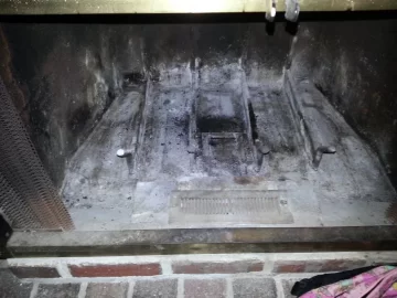

I am currently trying to figure out how to operate this fireplace in the house we just moved into. The fan switch does not turn on the blowers, there are two of them near the floor. I am hoping that there is a thermal switch or a thermostat which is not allowing power to the blower system, and that there just isn't a short or other electrical issue with the blowers.
I cannot find a model number on the unit, but while I was looking for this I noticed a metal rectangle on the floor which appears to open. I don't know if it opens, what's inside, or if this tells anyone anything about the unit.
I looked for a thermostat wire or switch or sensor inside but cannot see one.
Any help would be appreciated. Thanks.

Eeek! That is a $1.99 central heat/air register for house ductwork. It sure never was original equipment in any wood burning appliance or fireplace.

If the grate at the bottom front of the stove is heavy steel it may be the outside air supply and control. Can you see what connects to the bottom? If it is thin pressed metal then somebody probably replaced the original with a cheap HVAC register as BB mentioned.
If I was putting a snapdisk somewhere, the rectangular plate in the bottom center is probably where I would put it. If the plate pops open then take a look.
The firebox looks in good shape, little or no rust or warping. The fan looks a little small, maybe a .5 HP, 180 CF/m unit. Definitely not 2.5 HP. Possibly they put the small fans for short ducts and larger fans for longer runs...
If it was in my house and the sweep/woodstove professional signed off on the unit and the flue I would not be adverse to starting a small fire to see what happens. Make sure he looks at the front grate and the connecting pipe. Hot embers could fall down there. Everything connected to it has to be non-combustible with decent clearances to combustibles.
