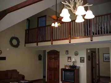

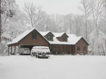

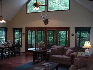

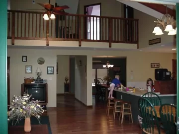

Attached are a few pics of the house and great room.
Nick

I was wondering where you would put a stove (masonry or perhaps a big soapstone stove) so that it has the least impact on traffic flow, yet appropriate visual placing. From what I can see the TV set location appears to be a possibility, would that work?
PS: Nick, did you make the antler lamp yourself? That's pretty cool.
The antler lamp is from "Lowes" .
If We went with a wood stove, it was going on against an outside wall of the great room (after building a hearth)
If We go with a MH it was going smack dab in the middle of the Great room, may be shifted slightly for traffic flow.
Even with the Wood stove I would be building a "masive stone hearth" so there would be some masonry coming up from the basement plus the evil outside chimney.
Nick

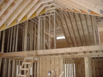

BeGreen,
"If" I ever build again, I am refining this design and making that center "Core" A Masonry Heater. (The area behind the TV)
As it is now if the Stove/MH was to go where the TV is, the flue would go straight up and block the walkway above. Behind that wall is a bath room. And above that is where all the roof framing comes together (see pic)
But the great room is big enough that if I make the MH "taller" not "wider" that it can work being in the middle.
We will build a cardboard mookup and move it and the furnature around.
Nick
