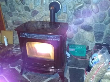

I switched from BK King to Harmon XXV. Don't regret it one bit. Well one bit, I had 6 cords of split and stacked firewood in May when I got it installed. (easy to give away). I wanted cheaper stove also. Considering CAB50, but went with Harmon because they are easy to clean. Has big ash pan. It lasts about 1/2 to 3/4 ton of pellets. Takes only min to do daily burn pot cleaning. Wipe the glass with newspaper.

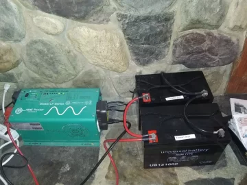

Downside is power outage. I also got 1250W Inverter/Charger (AIMS 1250), along with two 100ah Batteries. One battery is 6 hours (Started out with 1). They are wired together Parallel for 200ah.
Benefits are less chimney cleaning. I do it once in the middle of heating season. And at end. 1 Ton cleaning is easy on Harmon.

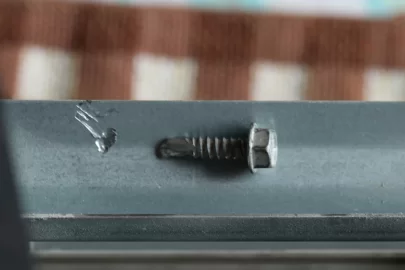

It had defect when I got it. Buzzing when warm. Annoying. Screws were touching distribution fan housing. Pretty sure the fan was going bad. I ordered another fan dealer was too slow for me. So Now I have spare. Plan on spare combustion fan and igniter. I replaced gasket last year. Wife smelled smoke (no smoke). Just to keep her happy. Easy to do. I think I have enough gasket for 2 more times sitting.
I recommend going bigger than stove smaller BTU. They can shut down and only run when temp falls. I run mine in Manual and switch over when nights get below 30f (Heat Pump).

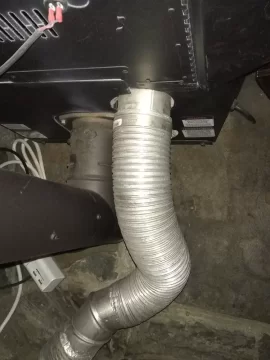

We put stub on OAK so the fragile piping does not come off when cleaning. (See pic). Also replaced bolts that hold panels on with thumb screws from hardware store for easy access when doing 1Ton Cleaning
1st Pic Inverter
2nd Pic Screw and Distro Fan
3rd Pic - Harmon XXV going strong
4th Pic - Stub on OAK

Dataman, all good information for me. I didn't realize that some stoves don't come with an ash pan. That makes little sense. I assume the fire must be out to clean the firebox on the models that don't have one.
I have also been looking through some install manuals and on some models the air kit is optional and others it mandatory. I have been using a wood stove for years and never had a problem, why would a pellet stove "need" an outside air kit?
Is it a problem running a large pellet stove at a low setting often? Idling as it were?
Thanks again for your pictures and info.
