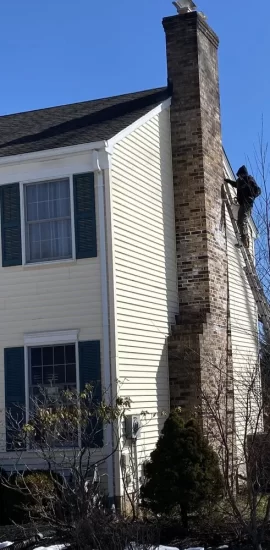

2 floors house plus 7ft attic chimney at highest point

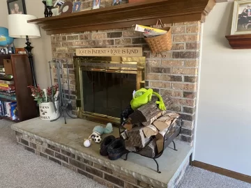

Center of room fireplace on right side of a colonial
Approx. 2400sq ft home
Brick fireplace
Width front- 34 inches
Width back- 24 inches
Height front- 27 inches
Depth - 24 inches

-You may (likely) need an insulated liner in your chimney going from a fireplace to an insert. This will add cost.

-I'm not sure how seasoned your birch wood I see in the pic is. Modern inserts need dry wood, <20% moisture content. It is unlikely you can buy that. Get ahead and start stockpiling wood. Most needs 2 years split, stacked, covered to reach a good moisture content. (Oak might need more.)

-The birch is decorative for now. I use Ash and Oak in the current fireplace.

Talk to more than one store (unless it is really highly recommended) and talk to them about the installation (assuming you are going to have them do it). One store I talked to said an insulated liner is not necessary even with an exterior chimney. He had good stove prices but I just didn't trust the installation.

it looks like you have a nice deep hearth where you could get an insert that sticks out a bit without adding extra floor protection. If that is the case i would stay away from flush inserts. Mine is flush, but my hearth is 16" from the face and i didnt want to make any mods. I dont get a lot of radiant heat, mostly all blowers. I mean the flush looks great, but any extra metal you can get outside the fireplace is a plus.
Im not saying it wont heat well, but thats what i would do.
