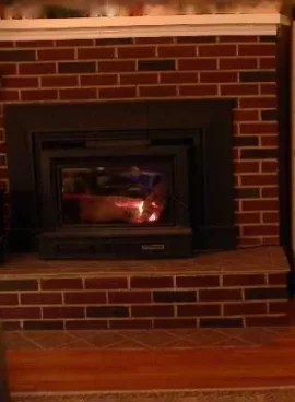

Usually, when you install inserts the only work that needs to be done is removing the current damper & handle which looked pretty easy, I didn't remove my damper but my installers did it in a couple minutes. The insert comes with a cord that's plugs into the front of it, and it can either be plugged to the left or right. I included a picture of my insert (it's dark I know) but you can see the cord that comes with it that hugs the hearth on the right side and plugs into an outlet.
The only time modifications need to be made is usually the exception. Even then, they aren't usually severe.
