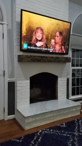

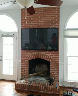

Here are the pics of the arched fireplace when we first moved in. We spruced it up a little just recently in anticipation of getting the insert. Hopefully by the end of the month we can share the final pics.

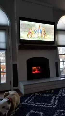

Finally got our insert... Did the first overnight burn last night, lasted short of 8 hrs. Pretty happy with this Osburn Inspire 2000 unit thus far... Hopefully my wood supply will season even more comes next fall.
