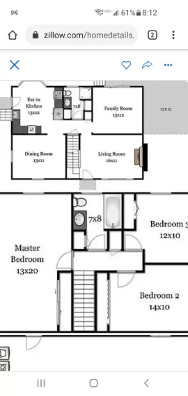

As I outlined earlier, they do quite well if the floor plan cooperates. There just needs to be a way for the air to move. Heres the layout of my 1600 sq foot two story cape.
My Osburn 1600 is in the 1st floor living room and as you can see the stairwell to the 2nd floor is in that room so upstairs stays nice and warm naturally. I use a single raised tower fan to push air down my hallway to the kitchen, dining room, and family room. The stove sucks the cold air back along the floor/up from the basement for combustion. You can feel it moving if you have bare feet.
On a 20 degree day a typical temperature picture of my place would be:
Living room (stove room) - 75
Upstairs bedrooms - 70
Family Room - 70
Kitchen/dining room - 65
Basement - unheated, 45 degrees ish.
I could make it warmer but we like it a little on the cooler side. Today was warm, 45 degrees or so. It's 36 degrees now, I haven't touched my stove since 7 am and it's between 68-70 in the entire house. I wouldn't say my house is super tight but we have above average insulation.

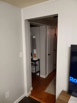

My tower fan is actually in the living room raised on an end table and it blows air into the family room. Then that air naturally heads over to the kitchen/dining room plus we walk around there a lot stirring up the air. The cold air returns along the floor and the stove also gets air from the basement thru the registers and gap in the basement door.
The tower fan is a little annoying as it's kind of an eyesore but it makes the heating plan work, it's quiet, and it cost like $30. Much easier than cutting holes in walls for anything fancier. If I turn the fan off upstairs will get noticeably warmer and the far downstairs rooms colder.
Here's the fan as viewed from the family room:

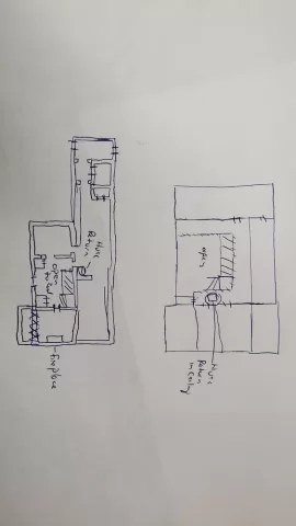

Here is a very poor drawing. The upstairs isnt as big of a deal over the first floor but the open foyer i suspect means most of the heat will end up there which at least the master bedroom we dont want. We like it cold when sleeping. Thermostat upstairs from 10pm ro 6am is 59F
