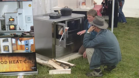

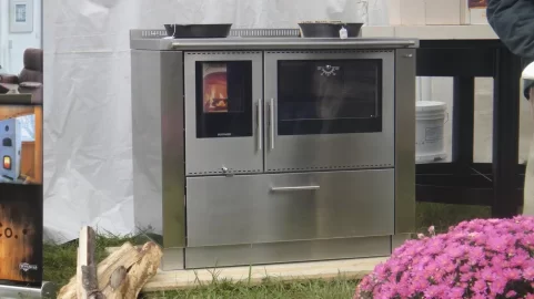

Those are good prices!
  • [Hearth.com] Wood Cook Stove
Reactions: Dune

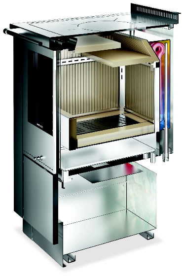

I remember the Esse literature saying that you can run a couple of radiators off it's optional water jacket. Has anyone done this?
Yes, the Esse Iron Hearth can do 2.8 kW to the water, what is around 9,500 BTU/hr. It's optional tough.
The Vulcano 7E5 and Pertinger OkoAlpin models have the hydronic heater build-in. It's part of the appliance. 28,000 to 68,000 BTU/hr to the water is hugh.
You can easly heat a 2,500SF home with this and also Domestic Hot Water for kitchen and showers.

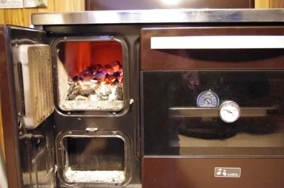

Here's my Sopkainc.com Royal cook stove merrily burning some coal. After it got going, it held 375 in the oven for hours. At the time of the picture, it was 300.
Reactions: BrianK
