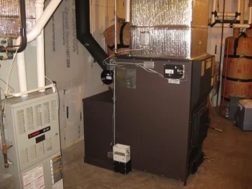

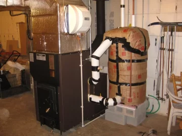

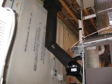

congrats! I just installed my VF100 this summer. Do you have a LP/NG furnace as well? If not, your install will be easier than mine. I had to run a gravity zone damper as well as a powered zone damper along with wiring for my humidifier as well as wiring to keep my LP furnace from powering up when the VF100 was in use.
Did you choose to get the water coil as well?
