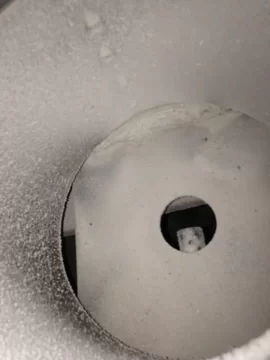

Here's my chimney after the first year of burning. This was after the burning the whole winter with wood that was 20-25% in MC. It's all flyash.

wow not what mine looked like at all after 7 days even
