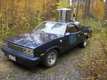

Here's one from Finland--the La Kamina, I believe.
  • [Hearth.com] Wood Gas Car
