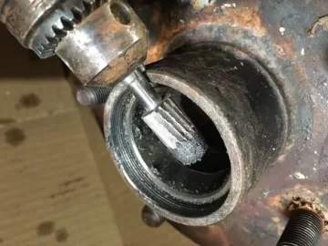

However in this case, I ended up getting in touch with a trailer shop, and they can get my hubs for $50 an assembly. Fully greased, everything ready to go, so I told him to order them, hopefully they'll be in tomorrow. I sent him pictures of everything and info suggested on here. The guy was texting me till 8:00 last night, he didn't care to know my name, credit card or anything, he said if they don't fit to bring them back. He was very helpful, so I'm going with him.

I was a little skeptical of the size posted because your picture looked like a larger difference in size from the inner to the outer. But again, a dial or digital caliper is your best friend.

I had a breakthrough yesterday, I decided to do some garage cleaning, and found some dust caps that were buried in my mess. They are slightly larger than the screw on hubs, so thinking about what @salecker said about how caps can be worked around, I found a metal grinder for my drill, and went to work on the inside of the hubs. I ground them down enough to tap the new caps into place. My dremel just happened to be sitting next to my vise with cutoff wheels, so I tried it on a stuck race, and cut through it in about 5 minutes. It drove out with minimal encouragement. Now I guess I'm back to researching bearings, races and seals.
The new caps will fill with grease, but they're not bearing buddies, so I don't plan on just filling them with grease, unless someone has a reason to..

I got the trailer bearings done today. I used the welder to help remove the stuck race. The first spark surprised me, even though I knew it was going to happen. I didn't think about welding the race to the hub. I didn't, that would have really sucked though. LOL The outer races were harder to drive in than the inner ones, my guess is that's why they were harder to get off.
