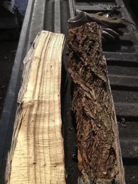

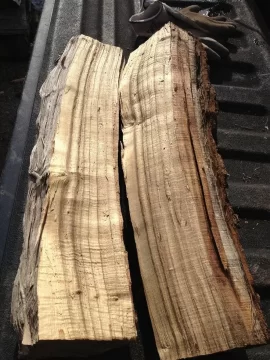

Alright, this stuff has been seasoned for 16 months and I am getting 37% from my moisture meter on it. Red oak that I got at the same time in 2011 is giving me a lower reading than this stuff, and that wasn't a really big split. Was wondering why it felt so heavy and why it was burning so terrible.
Thought I was 100% sure what it is, but now I have my doubts.

Looks like Honey Locust. Shoulda been dry by now for sure unless stacked in a plastic bag.
That's Locust, I'm not sure Black or Honey, but definitely a Locust. You can easily tell by the X's in the bark. It probably also smells like Olives when cut!
Looks like BL to me. Was that one split, and you halved it to measure? How big was it? BL is supposed to dry pretty fast, I thought. What were the stacking conditions?

Yeah, locust is what I thought it was too, and I have no idea how the heck it is still this heavy and wet, but it is burning like crap and it was c/s/s in August 2011. Thankfully we did not have a terrible winter because this was going to be my go to stuff for the really cold nights. I think my error in stacking it was that it was protected from the wind by the house. I am going to move it to an elevated position where it is not shielded from the prevailing northerly wind and hope that it will be ready for next winter. Just hard to believe, and frustrating, that the red oak I c/s/s a month after this locust is a lot drier than the locust.

Just for kicks, how did you place the probes to get your reading?
Yeah, just for kicks the answer is along the grain, and I tried to get them as close as possible to being in the same ring. Put another way, if you look at the pics, one prong would be north and the other south. Did I get the placement correct? Actually, let me run back outside, split another one, and try it the opposite way.
Yup, that's how you do it. Split it first that way you don't read extra surface moisture or extra dry surface.

Just went and measured the one I split earlier today that measured 36%. Now, with the grain it is coming back at 25%, but that is in nearly the same spot where I measured it earlier (i.e., too dark outside to go swinging the Fiskars). Against the grain it is coming back at 22%.
Now, I am sitting here and wondering if the moisture could have dropped that much in just an hour on the exposed side of the wood. There is one thing I know for sure, these pieces of locust feel a lot heavier compared to anything else in the stack, including the dead standing oak that I just got that is coming back at 31%.
