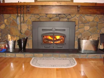

I'm loving my Declaration. It has a very big firebox for an insert and can take a 24" log in the front.
I would have liked a stove but as you stated my wife wasn't having it. She thought the Declaration was pretty and I liked the big firebox. So it was a good compromise for us.
Happy hunting and good luck with whatever you decide on.
