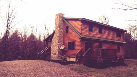

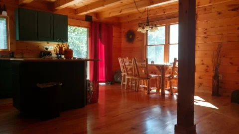

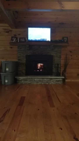

Got any pics of the log cabin? We have one in our neighborhood, interior is really nice.
A full liner is definitely what should be installed. That will be safer, better performing and should have been done from the start. Does the current installation have a block off plate in the damper area?
Yes, the current installation was put in with a block off plate. I probably should have had a certified chimney sweep inspect it prior to having the installation done but it never crossed my mind that a relatively newly professionally built log home would have any chimney problems, especially given it's size and little use over the years. It had only functioned as a cabin for two couples from the city like 6 months out of the year. At the time of installation I was left with either doing it this way or having to pay a lot more money to have them haul it back, get the chimney inspected and fixed, and then paying them to come out again to try again. I live so far out that I get charged extra for almost everything due to travel time. Now that I'm realizing how unsafe and underperforming this set up is I'm just going to have to do it the expensive way.
If you haven't had it swept and inspected then that would be money well spent.
I have a few. I live really far out in the middle of nowhere. No neighborhood here.
