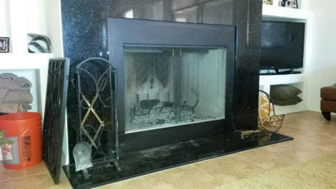

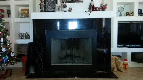

Good Day All,

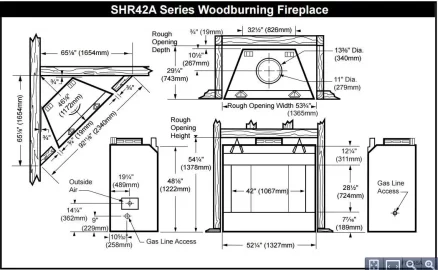

Newbie here, coming to you live from Prescott Valley, AZ. I Currently have Majestic SHR42A ZC fireplace. Looking to identify if i can put a wood burning insert or a free standing stove in this unit. if so, How does one decide the size of the insert or stove to go with?
Current primary heat source is Heat Pump. Looking for a heating solution to provide comfortable environment and primary source when outside temp is below 28 degrees.
Home is a single level 2800 Sq/Ft.
Pics attached of current Majestic dimensions and Fireplace setup.
I had a local FP store recommend Kuma Ashwood.
Thanks in advance,
Tony

It MAY be possible to install an insert inside your ZC box, but I would be hesitant to put too much weight in there.
Your firebox is primarily fabricated from this sheet steel & does not have a whole lot of strength.
Putting a couple of hundred pounds in there may cause the metal to collapse. Also, the chimney system for this type of
unit is not rated for the elevated temperatures of a sealed woodburning unit. You will have to remove the damper & run an insulated stainless steel liner down the full length of the existing vent. You will also need to get creative on top of the chase to ensure you have a leakproof seal where the cap is attached.
I would compare the costs of an insert, liner & labor with the costs of a complete tear out & the installation of an EPA-rated woodburning fireplace, then make the decision.
One option would be to extend the hearth so that a freestanding, rear-vent stove could be placed in front of the fireplace. It would still need a full stainless liner.
