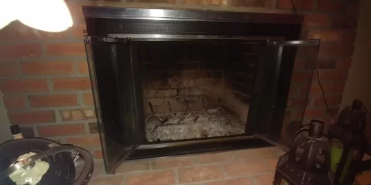

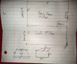

Its opening 34+ x 25. . .
25” lintel height? The BK inserts are nearly 23” tall. Attaching the liner pipe to the stove’s flue collar with only ~ 2” clearance is going to be the tricky part. The Sirocco has a removable flue collar to make it easier. Nice big glass on the Sirocco too, but if the Princess will fit, I would go with the Princess’ larger firebox for your space. Unless your biomass boiler is heating the house just fine, and this insert is mostly for show,

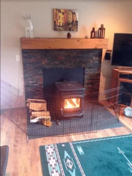

Here's what my Jotul F45 looks like. Insert was too expensive in comparison and I like how it turned out, plus on these zero degree days it pumps out the heat!

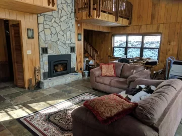

Would love to see some pictures
Here's a photo. the stairs lead to the loft upstairs.
As an example, I loaded the box at 11 last night, let it get up to 1000 on the cat thermometer and pulled the air back to 95 percent closed. It was 72 at the windows when I went to bed and this am at 8, it was 65 at the windows. If the blower was up higher it would maintain.
