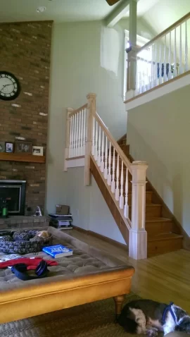

Hello
I'm at a crossroad. I definitely want a long burn time and love the openness of a traditional fireplace. Dont like inserts that protrude outward. Like the more modern looking flat options.
The room the insert or the stove would go into has cathedral ceilings. The insert would go on the first floor. It opens to the kitchen as well. The stove would go on a second level loft that looks down to the area where the fireplace is located. It abutts the master bedroom.
The stove would require piping that's visible from the front of the house, coming out the roof. Not ideal but...........
Here are my list of likes
Inserts:
Destination 2.3
Recency CI2600 or Altera
PE Alderlea T5
Stoves:
BK
Hearthstone(Phoenix,shelburne,Manchester)
Woodstove
Wood stoves we love the enamel painted or matte black look.
Great wood supply moisture content less than 20%. Room area is maybe 8-900 sqft.
Open to any suggestions.

Is the fireplace a masonry fireplace or a metal chimneyed zero clearance fireplace? Pics and a quick sketch of the floorplan may help.

What's currently in the fireplace? What are the fireplace dimensions (opening and back, and depth top and bottom.) How large an area will be heated?

Its opening 34+ x 25. Dont have the depth right now.
Nothing is there right now. Just masonry

Freestanding would go on a second floor loft.
I'd just install the insert and try it out for a season before proceeding with the second stove.
. . .the heat from an insert will go up to the loft quite readily.
Also true for a freestanding stove. If you're installing only 1 stove/insert. I second the recommendation that it go on the ground floor.
-- I would very strongly suggest that you consider;
1. Negotiating the stairway with a load of firewood. Both the effort and risk of injury look very high. Also damage to the walls and railing.
2. Chimney height required for an EPA stove must also be considered for that second level install
