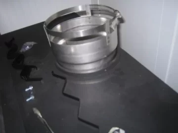

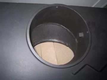

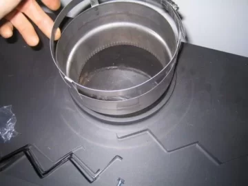

hello all.....great site, I have been navigating for a few hours now and am looking for some help.....I recently bought an Avalon Pendleton stove and am going to use it as a woodburning insert in my existing masonry fireplace.....so a few things, I have purchased a stainless steel flex liner to run all the way to the top of the chimney, it seems that some recommend insulating the liner and some think that it is not needed, is it worth the extra cost to do this????? as I am remodeling my home and am on a bit of a budget.....next off, my unit did not come with a baffle blanket, that upon looking at the manual, sits on top of the baffle bricks, is this an integral part of the system that I must have??? And lastly, I am looking for some insight in attaching the liner to the insert....I attached pictures of the connecter piece, and the top of the insert.....it appears that there is a small metal tab inside the insert opening that does not allow the connecter to seat fully, could I just use some tin snips and cut a notch in the connecter??? if so, once it is seated fully, how should that joint be treated???? a silicone bead????

those metal tabs are stops and that's as far the connector piece should go. Two suggestions screw it in place and stuff gasket material around it or cement is up with gasket cement

I cut a notch on mine,there is only one tab on that collar and it is
only one inch down the collar and i did not feel safe with that.
I cut out only another 1/2 in notch and used furnace cement.
