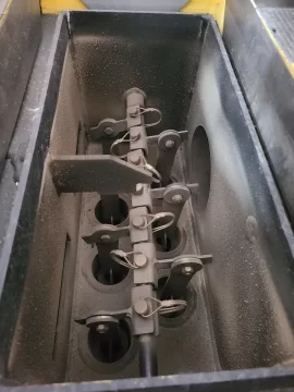

Easy to access turbulators for end of the year maintenance/ cleaning.
