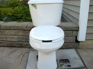

Don I have the answer for your hopper extension, [Hearth.com] Wood Pellet Stove - Home Made Hopper Extension!The base is cracked and I had to replace, was gonna make a chimnea out of it (it did take good size logs) you can use the tank. It's noncombustable and will hold a bag of pellets. Yours free, come and get it!!:cool:
sorry not the right color and may crack easily. LOL
Don I have the answer for your hopper extension,The base is cracked and I had to replace, was gonna make a chimnea out of it (it did take good size logs) you can use the tank. It's noncombustable and will hold a bag of pellets. Yours free, come and get it!!:cool:
What a crappy idea. :p
