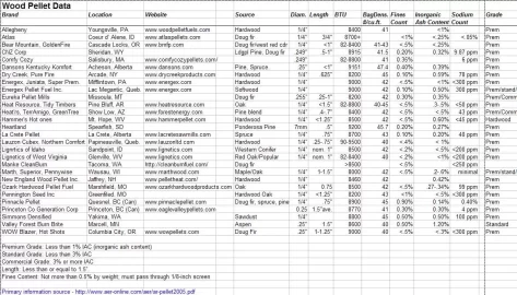

EDIT: I just found the chart I posted awhile back. It looks like the Valley pellets are a bit long (1.5") and have a much higher inorganic ash content. They are considered "standard" grade, not premium. So definitely try before you buy.

Yeah, I would definately like to try some before buying a year's supply... I agree, at $150/ton, if they are any good. I'd buy a bunch. As for Marth...I've heard some not so good things about them. Now, they could have improved their pellets since. I had a couple problems last year with my Mt. Vernon that the technician blamed on pellets being to long. I don't want to go through that again. Thanks for the data sheet.
Yes, I'd stick with premium grade pellets. (info updated below)
