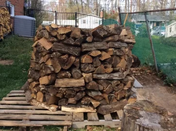

[Hearth.com] Wood pile advice After two times of stacking oak on a landscape timber/cinder block/2 x 4 wood rack, and having it collapse each time, I gave up on it this morning. I turned the woodpile into a holzhausen/holzmiete type of stack. I've never attempted one before, but it seems pretty sturdy as far as it has gone. It's less than half a cord at this point, and I do plan to build it up a little higher. Of course, I had thought I'd done a great job on the last stack on Saturday until I found it nicely arranged on the ground this morning.
My question for those of you who have used this method is whether you have strong opinions about the center part. We were thinking of moving our chunks and uglies from a pallet to the center part. Then we could use that pallet to stack more wood. (We like to maximize our wood storage space on our 1/4 acre.) Would this significantly slow drying time? What would it do for the stability of the pile?
I'm open to all input here. I'm under no illusions that this is a superior method for drying firewood, but as long as it stays up, I figure it's better than the wood ending up on the ground repeatedly. (We're still a little mystified about the collapsing wood rack, but I wasn't up for a third attempt in the same manner.)
View attachment 196918 After two times of stacking oak on a landscape timber/cinder block/2 x 4 wood rack, and having it collapse each time, I gave up on it this morning. I turned the woodpile into a holzhausen/holzmiete type of stack. I've never attempted one before, but it seems pretty sturdy as far as it has gone. It's less than half a cord at this point, and I do plan to build it up a little higher. Of course, I had thought I'd done a great job on the last stack on Saturday until I found it nicely arranged on the ground this morning.

You know, when I brought my husband outside to show him what my daughter called "the most disastrous disaster of disasters" (she's young and sheltered), we actually discussed that as a possibility but dismissed it as pretty unlikely. The neighbor whose fence it borders used to heat with wood and misses it. We did wonder about the teenage sons but still think it unlikely.
The first time the stack fell, we think there were several contributing causes: a slight slope away from the fence, some shorter pieces mixed in the rack (which my nine year old helped stack), and we actually think that the chain link fence may have wobbled when the neighbor's cat jumped on it (a regular occurrence) and struck the rack itself. You can see in the pictures that it leans. We subsequently moved the rack out farther from the fence and slightly repositioned it so that the wobbly fence couldn't touch it. When I re-stacked, I made sure all knotty pieces or shorter ones were put on last. They were pretty tightly stacked, so much so that they remained neatly stacked together when they fell over. Only one piece remained on the rack in the corner. I figure maybe the ground settled forward or something, or there was more lean than I thought, but I checked and checked. I figured I really couldn't do it any better, so I decided to go for a different technique.

Thanks for those thoughts. I'm afraid that since we process wood in our children's play area, we're pretty committed to getting it stacked. We also need to maximize our drying time since much of what we handle is oak. We do only process a little at a time, though. I can see shrinkage and shifting in our older racks, so I know what you mean. In our case, though, it must have been a problem with the rack or the stacking because the first time the top and middle toppled forward in the night after it was completed. The second time the whole thing fell en masse within 48 hours. The one advantage to stacking it three times was that I got a little more bark off each time.

I did put a tilt toward the center of this pile. I had read about that on here. At least it's still standing this morning. I may decide to move chunks and uglies today. I figure that will improve the aesthetics along the other side of the house, and the holzmiete is a much sunnier area, so maybe it won't be too bad. An interesting experiment.

The rack was in the southern corner of the yard, and it got a lot of sun on the back. It still got sun on the front, though, as the trees aren't leafed out yet. That will change soon. It toppled in the direction of less sun. Would that be a factor in such a short period of time?

I can't be 100% sure but 2 times I've had racks that had full sun on one side and little sun on the other fall. They fell towards the direct sun side.
The only time my stacks have fallen was because I made them way too high. Yes a nice high stack looks cool and is rewarding but definitely not practical. And by high I mean about 6ft off the ground. If I keep it to 4 then it's fine. We had a wind storm a month or so ago with 80+ mph gusts and my stacks held tight, surprisingly...
Just be mindful to keep everything straight and even as you're stacking. Takes a bit more time but picking up fallen stacks is the worst.
2 1/2 years ago I built my first holz, 12ft radius and approx. 10ft high at the highest tapper. I used pallets to keep the wood off the ground and purposely threw the smaller uglies in the center hap hazardly with the thinking of if its stacked neatly air will not exchange in the center. My holz is estimated at 5 cords or so. It has budged, the only thing that has moved in that stack are the poor pallets, some of them have collapsed.
After doing this type of stacking I've determined that all outdoor piles will be stacked like this, there stability is excellent, piles that will go into the wood shed or driveway stacks will be stacked traditionally and neatly.

Mine was probably about five feet off the ground, though ten inches or so was the cinderblocks and landscape timbers. My husband will probably try it next when he has a chance to saw some pieces down to length so that I can split them. He plans to keep it a bit lower.
I was so disappointed when my rack fell since I had spent so much time stacking it straight and even. I figured I really wasn't going to do it any better, and I needed more stability. At least the holzhausen is still standing tonight.
