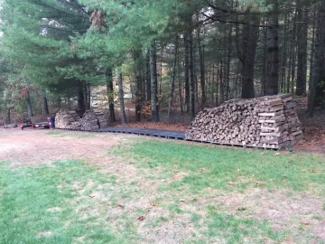

I cut everything 22" and used to stack on wood pallets but got tired of cleaning up the rotted pallets and nail mess every few years. After having a few "should have been replaced last year" wood pallets cave in on me and loosing a few stacks, I'm converting over to HD plastic pallets. I looked into the stack brackets like you have, but over time wound up acquiring all of my plastic pallets for free from my work.
Now my 22" splits are stacked 2 rows deep on 42" x 48" plastic pallets with a 4" air gap between the rows. My current setup is 18 pallets long x one pallet wide x 4.5 feet high, so about 8.5 cords with the stacks running east/west with full southern sun exposure. I have another 2 cord stacked under the deck for easy access just outside my walk out basement slider which is in the stove room. Another "brick" of stacks is on wood pallets out back with good morning sun exposure.

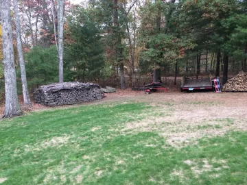

More stacks.

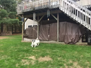

Easy access under deck stacks.
