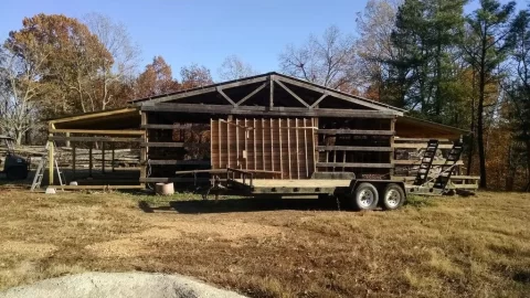

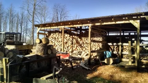

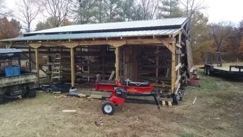

I did my first woodshed never havind done a metal roof before. A couple youtube videos and i was ready to rock! Betwwen my daughter and her boyfriend, we go the roof up and done in about 2 hours. This was a 10' x 21' or so roof. See pics below.

Fork it, here's pics of the woodsheds:
Woodshed #1:
[Hearth.com] Wood shed roofs
Woodshed#2:
Both woodsheds, #1 on the right, #2 on the left, pole barn in the middle:
