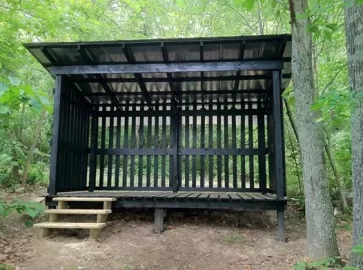

So, with the help and information I gathered on this site, I finally finished my new shed. It's 12x6+ and should hold just over 3 cords when full. I don't have any flat ground on my property so had to build a deck. I used a thick black creosote type stain that I hope will reduce bugs.

I built a 12x7 recently I am curious where did you get the metal roofing, and how many sheets did it take?
Welcome J45. :) Nice shed, looks like it will breathe well. I can get by without a shed in this climate, but it sure would be nice to have one. I've been thinking of slapping together a pallet job; Wish I could find that recent thread with Hogwildz' pic of his. I need to get probably close to two cords in there, and I'm thinking of making the sides about 6' high, with a nice overhang like yours has. I've got some metal roofing lying around but probably need more.
Reactions: GibsonJ45
I got the metal roof panels from a local building supply company. the shed is 12' and a bit long, and the panels are 26" wide, I needed 7 panels all together.. be sure to account for the overlapping you need to make it water tight. The stain I picked up at a farm supply store. It's a fencing/barn stain for $12 a gallon (very cheap but good) ... I know... I probably put more money into this shed than I wanted to, but it's near my house (I can carry the wood straight into the garage!) and the wife wanted it to look nice. And I got tired of grabbing wood out from under wet, snowy tarps!

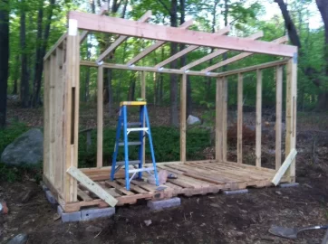

I had a similar design but built it on pressure treated pallets courtesy of tractor supply. I spaced the studs on the side to line up with the middle of each row of logs. It is 80" deep so I have room for overhand in the front and back with an 8 ft panel I was planning on the same 7 panels at 26 inches. I was going to lay it out on the ground to figure out the overlap. And I need twom more rafters. I went with hurricaine straps bucause I got to lazy to make the cuts.

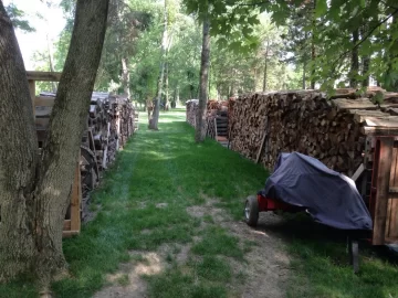

My plan this year was to level out the ground inside of it. Right now it's like a 5% grade front to back and a huge nuisance trying to walk around in it. I also want to add a partition so i can stack neatly and higher. Right now i'm a lazy stacker and just toss into a huge pile as I split :eek:

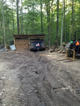

I have two of these - 20w X 10d X 9H Holds around 14 cords each Built cheap I think I only have a few hundred in them

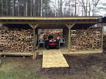

I've been debating shed options for a few years now, and one like tigger's would work well for my space. My primary plan had been several 50 foot long x 4 foot wide roofs, covering each of my double-wide rows:
[Hearth.com] Wood shed thread
This plan is an inefficient way to store 30 cords (3 years) of wood, but it's very conveniently accessible by tractor for stacking / un-stacking, and I could season my 3 years directly in these long "shed rows."
I wonder, if storing this amount of wood under roof in tigger's configuration, multiple rows deep... could wood be seasoned in the shed? I hate the idea of maintaining both outdoor stacks AND a shed, moving wood more than once, given the volume of wood I'm processing.
