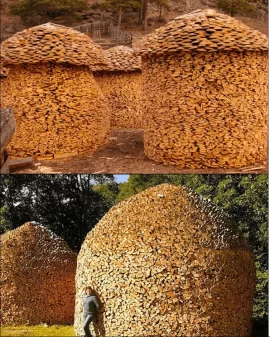

It's dark now. I'll take a couple of pictures tomorrow. The pipe is a 10' standard drain pipe - perforated, buried vertically 2' in the ground. This is just to keep it in a standing position, you could do it anyway you like. The idea is that the air is drawn through the pipe, so you really want the bottom sealed. The air is drawn in through the perforations in the sides of the pipe, so it has to draw it through the wood pile, then exhausts out the top. The tarp is to protect the wood from the weather. I just orient the pallets around the buried pipe so I don't need to cut a hole, but there's no reason you couldn't. This does yield a square pattern, but I just leave the corners sticking out. I actually use splits and small rounds in the perimeter of the pile, but it all depends on what I have available. Once the perimeter is started up a couple of feet or so, you can just start randomly throwing stuff inside it, splits, rounds, whatever. When I send the pics it will probably be easier to visualize. I'm told this is a technique that was commonly used in the north east many years ago, but you don't see it any more. They actually look kind of cool too.

But are they creative looking piles?

Check back tomorrow, I'll post some pics to this thread. I actually like the appearance. I'd like to get some EPDM or something I can cut to a round shape rather than the tarps, but that's what I'm using for now and they are a bit on the ugly side. What's nice about the EPDM if you can find it is that it is heavy enough to stay put when it's windy. That is also a negative when you have to remove/install :)
What is EPDM? I may have misunderstood earlier. Is the tarp on top of the pile to provide a rain/snow barrier? I thought in your description it as on the bottom of the pile. Looking forward to the pictures. Thanks George.
The tarp is on the top - no covering on the bottom. You want the bottom open to promote airflow through the bottom of the pile, which is one purpose of the pallets.
Gotcha, making perfect sense now. I am intrigued by the round stacking method as it is self supporting. Hate stacking in rows when the splits are non-uniform.
Exactly. What's really cool about this is that because the outside diameter of the outer course is larger than the inner (15" splits), non-uniform splits work perfectly to even things out, but putting the larger end to the outside. I do like the simplicity of no end supports, or ropes through the middle as I've seen others do. Not sure why this method fell out of favor, I love it. Pictures today were really bad, since I didn't make it out today and took a picture through the window. You'll get the idea. I will post after dinner.

Sounds like George has created a wood version of what farmers called a "corn crib". It too used a chimney effect to draw moisture through the cobs and out the top. Good thinking, George. I like any idea that minimizes my stacking time.
The other benefit is that the moisture content is very consistent and the wood dries to gassification levels of 12-20% in one season. I still season mine 2 years, which makes it more consistent throughout the pile, but it is nice to know that if I get caught short, next years supply is probably fine to use. We're in a very cold winter it seems, so this is probably going to happen soon.
Well, I believe this is how I'll go about seasoning from this point forward.
