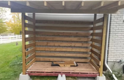

Easy to build shed, holds 1.5 cords

Is that all treated wood?
Sides are, the rest is old stain I had lying around. Wanted something on it before winter. I'll stain it all Grey this spring. 5/4x6 was fairly cheap.
