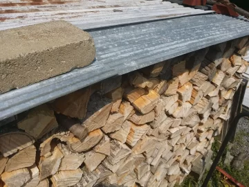

Throw a couple of pallets on top of the piles with a bit of slant. If you can find some steel roofing it would work great, especially if you have it overhand the sides of the stack, otherwise overhang the pallets over the sides and attach a tarp over the top of the pallet leaving the gap open to the air. I have wood shed for my current winter wood but it doesn't store all the wood. I have stacks on either side covered as described, once the woodshed empties out I pick a nice winters day and move one of the stacks indoors.

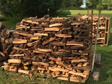

Nice looking wood stacks there Fred. I use 6mil black plastic too and mine will last several years even in the direct sunlight. Get you a bostich/arrow hammer stapler and staple the plastic down both sides a little(about a ft.) and it will stay for a long time without a worry :)

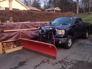

Noreasters here will often blow snow/rain and refreeze the slush in a stack to where you are busting splits out with a sledge hammer and thawing them in the garage or basement floor for days if not weeks.

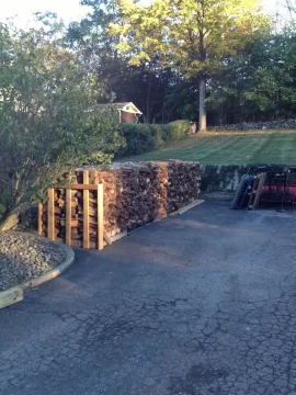

Having had to do the above several times I'll cover the north and east sides of [ at least ] the stack I'm pulling from. I have a little wood shed that holds about three days outside the back door and can keep a couple extra deals on the porch in a pinch if need be.
I load a face cord at a time from my stacks to this little rack that I built under my carport. It's just outsied the side door, so it's very convenient to go out there and load up a couple 5 gallon buckets to bring inside.

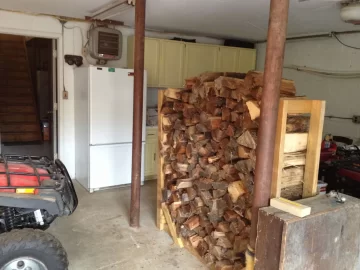

This is what I did last year, brought a seasons worth in the driveway, covered it with tarps, then had the supply in the garage. The funny thing is that I ran my old stove until the 1st week of December. I was filling that rack every 4 -5 days with the old stove, installed the BK princess and that rack would last me 10-12 on average, and it was a very cold winter.

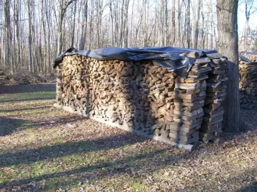

I usually just tarp my over-winter wood with 4'x16' tarps to keep the snow off, the wood stays dry and continues to season even in the frigid cold. I get the tarps from I think Northern Tool, very inexpensive, they usually last 1-2 years.
