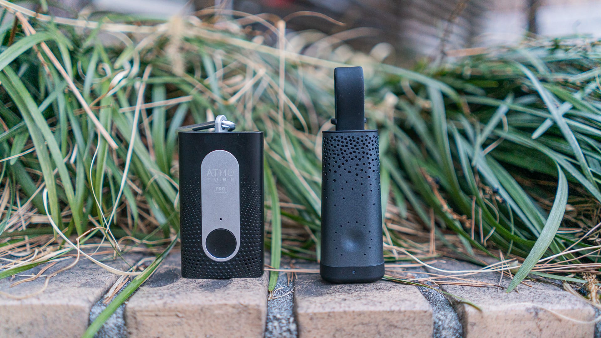

We live in the Rockies where our air monitor device (Atmotube) usually measures air quality in our log home from 93-97%, which is excellent. I have tested the air quality when our PE T6 is running to heat our home and find readings in the same 93-97%.
This honestly surprised me but am glad to see our wood stove does not affect air quality. So it may be worth looking into an air quality measurement device or consider an air purifier. Some of the air purifiers indicate air quality

I have Atmotube Pro but there are a few more. I have checked it against readings from other public monitors and it seems right on. It does not have NO2 but I depend on the readings of monitors in the area that I can look at an app
Plume, AirIQ and WeatherUndelrground all have free apps that you can check your general locale
But you will need a device if you want to compare your household air with and without wood fire
