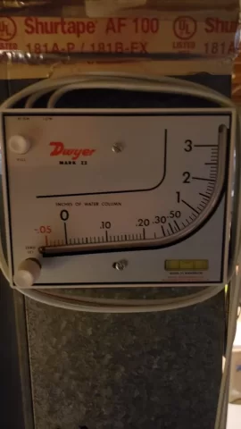

I use the old school Dwyer Mark ii manometer to measure pressure drop on my hvac filter. Its only like $45 on Amazon and if its helped me save a ton of money on filter replacements. I also found the 3m 1900 Merv 13 to be an incredible filter. It has an extemely low pressure drop and can last for a really long time. I was also quite surprised how restrictive all the cheap low merv filters were as well.

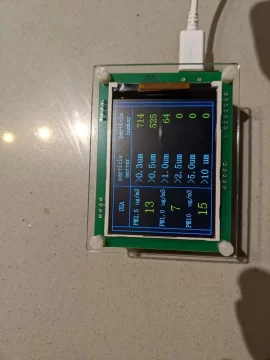

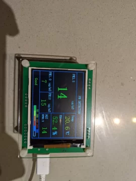

Got my monitor delivered today, so far I'm pretty impressed with it, was sitting at 1-5 ug.m^3 for PM 2.5 when I first turned it on for about an hour, then went outside and lit the pellet grill to cook supper, a little bit of smoke came in the door and right away it hit 76 ug/m^3, basically as quick as you can smell smoke the sensor is detecting it.
Will be interesting to see what it shows over the next few days, and even tonight when I light the stove again.

@ABMax24 , awesome.
Be advised, the little number bottom right corner on the main screen, the "AQI" number on these items uses the Chinese AQI calculation, which is different from the USA EPA spec (more conservative) and the World Health Organization (WHO) calculation, which is even more stringent.
What I am seeing so far at my house is PM2.5 is almost always the controlling pollutant for calculating AQI. I am seeing more PM10 with cold starts than I do with hot reloads, but day in and day out PM2.5 is the thing to keep the closest eye on, at least seems to be so far.
In the US, PM2.5 from 0-6 mcg/m3 corresponds to 'excellent' AQI, with AQI numbers 0-25. 6.1 to 12 mcg/m3 @PM2.5 corresponds to AQIs from 26-50, "good" in the USA.
There is a PM2.5 to USA AQI calculator here: https://www.airnow.gov/aqi/aqi-calculator-concentration/ that returns 14 mcg/m3 of PM2.5 as AQI/55 - unhealthy for sensitive groups, aka moderate.
I haven't found a WHO calculator yet, there is a decent wiki article here: https://en.wikipedia.org/wiki/Air_quality_guideline

How could this be fixed? Well, many of those HVAC pros have gauge manometers, and know the nominal cfm and rated max pressure drop for every air handler they install. If the cfm (per square foot of filter) is below a threshold, and the max pressure drop above a threshold, then they KNOW that a 3M MERV 13 filter is aok and they could just tell the homeowner that. The govt could help by certifying high filtration filters that have a pressure drop below some threshold as 'gold rated' or something. The HVAC guy says, you can put any filter in that had a 'gold rating'. DONE.
I am telling you that 100% of the air handlers installed in the last 10 years can handle these filters....they have LOWER drops than the low MERV filters from 20 years ago.
